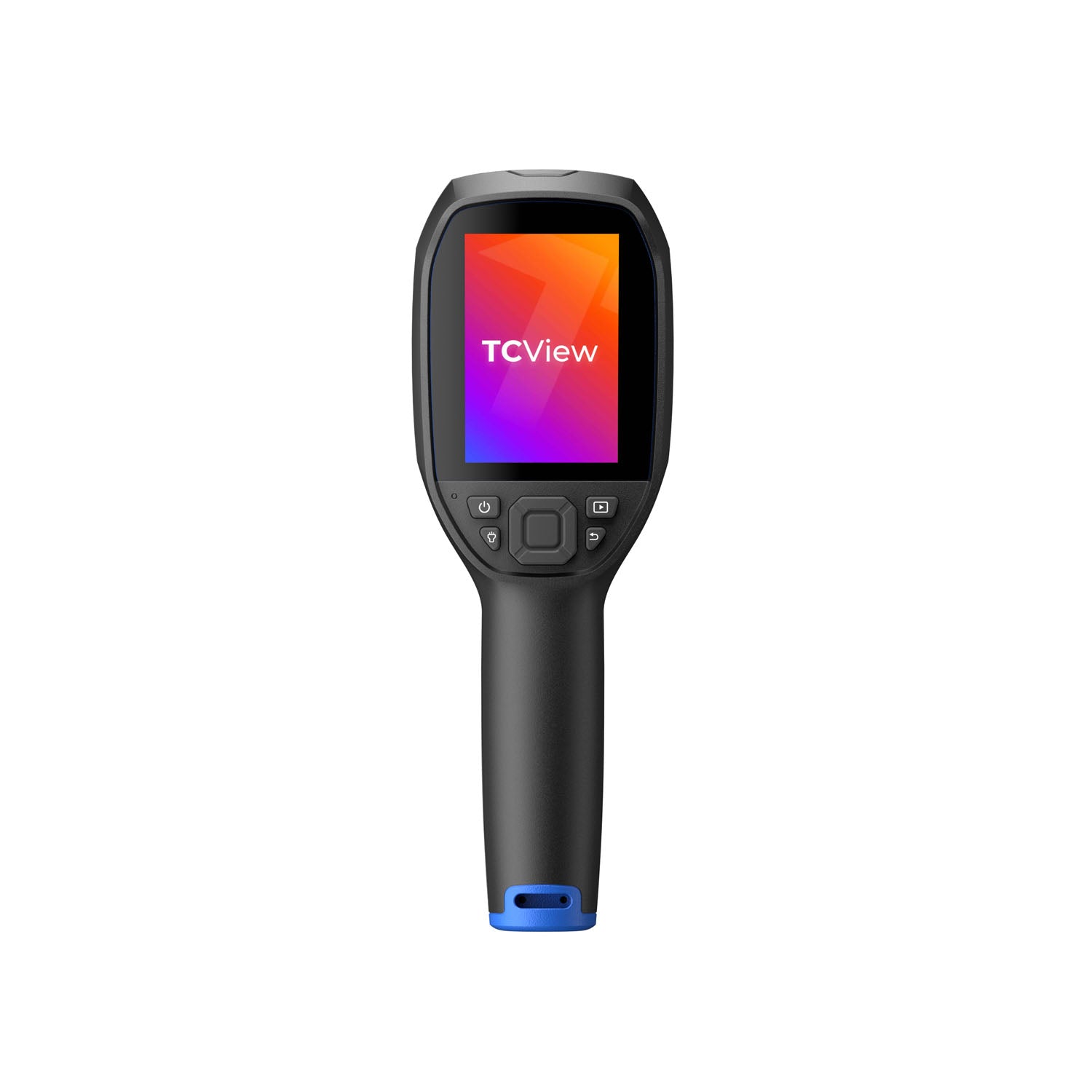

So finally pulled the trigger on a IR camera gun. Should help out in a lot of other areas as well.

Well this showed up, today about 2pm, had to help my uncle around the farm..
Just got to start playing with it and figuring it out this evening..
It's sensitive enough I can pick up my own body heat off reflective stuff.

I use those on boats to look for small shorts. LEDs are becoming an issue, bc they don’t pull enough amps to pop a breaker of fuse when they short. Had one smoldering and still hadn’t broken the 2 amp fuse.
