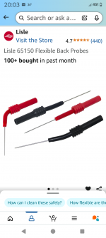

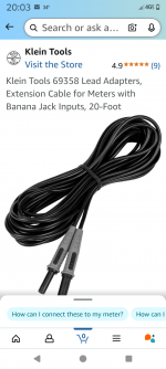

My arms and leads aren't long enough to go from one side of the truck to the other. For any of the ends on the PCM connectors.
Don't have time to dig to the cam sensor tonight.
