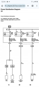

Pulled some stuff out haven't found anything yet..
Trying to back track/reverse diagnosis stuff
Given this video of me trying to start the truck..
Source: https://youtube.com/shorts/1Ya4wLTB-8I?feature=shared
My brain is thinking, if I can find where the relay controls are for the starter relay which is probably close to the run/crank relay controls. Should give me a starting point of sorts.
So far all I can find is load side circuit not control side circuit, for both run/start relays ?
Edit found BCM pin out diagram.. all the problems I'm having running through.. it including PK1444 circuit runs right through it...
Think I lost the BCM or at least part of it???‍♂️
