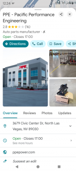

The Headquarters moved. I don't know if the moved both stores or just closed them. I just know they settled the CARB thing in 2021 like PPE and they said F-You to CA.
Looking at Google maps and it now shows that branch as "Duramax service center". So possibly rebrand or sold it

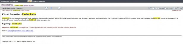

Is that the Fusible link? I believe It goes from back of alternator post to Fuse holder. Mega 175 Amp
I know a friend of mine had an issue on a GMT400 with his. It turned out to be a connection/ corrosion issue. Of course he also had to replace the alternator because it partially melted it. But luckily it was under warranty at his local parts store.

There is a 175a maxi fuse for the Alt charge wire. And it's located on the PS firewall..
AFAIK there's no fusible link in the cable.. that would be news to me on either of those locations
You are probably right since it goes to a maxi fuse.
The GMT 400 and GMT 800 Gas versions are different.
