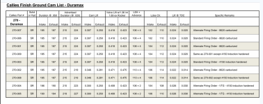

I left a message with "Justin" at Callie's about their camshafts and if they would make a custom one..
List of publicly available cam shafts
Did get a quote for a cam doctor.
Left a question with Wagler, can't get a hold of anyone at comp cams, haven't bothered with
industrial injection yet.
This is closest to what I've found... If it's legitimate
PPE, Socal, Wagler brand cams don't release specs and few times I've talked to a rep it's talking about a blind shot in the dark with a blank check??‍♂️

Is it really worth the added cost just to mimic a cam? A callies stage 1 will do everything you want and is ~$700.
All of the below cams do not require reliefs.
Comp has 2-3 options
Callies stage 1
Wagler stage 1
SoCal 3388
