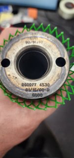

Well cam is out and on the bench..
Going to use those AN aluminum vice jaws some steel plate and a dial indicator to check lobe lift.
Got one lobe at ~.365 and one lobe at .303 which would be .496/.509?
Been a long day, might have not kept the cam in the grove..
9,266
1,514
Got everything measured best I could.
Intake lobes run from .352-365" @ 1.36 is .478-.496
Exhaust lobes run from .301-.306" @ 1.68 is .510-.514
Then subtract lash of .010-.012"
My keyed LMM cam is avg .286/.234 lobe .388/.394 valve
