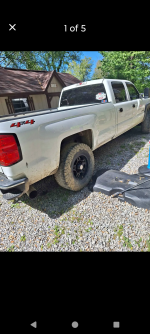

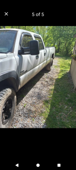

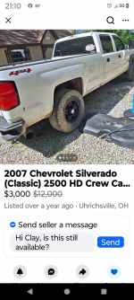

Searching for beds...
Found this picture in a FB add
Looks like LML/L5P bed on a 800/900 chassis
