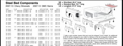

He gave essentially what looks like 2-#4s going to shop around see if I can find some #6s before I eat the LMC premium
