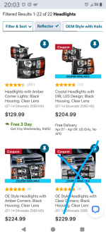

DS headlight assembly on low beam just floods vs points a beam, swapped bulbs and no difference.. yeah for Chinese knock offs???‍♂️
PS lights the ditch up about 6' to the right of the white line.. not sure if that's bent frame work or not yet.
Had something similar to these on my dually
