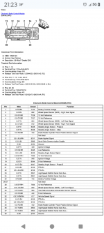

Based on the picture of what I can See, I am guessing you have the JL4 Except 10 series option? The melted pins 13 and 38 are both battery+ voltage wires.
In which case they list 19178085 as being a service number. and its the only plug I can see that looks like yours.
I believe the other use the same plug but are wired differently, except the JH6/JH7 option which has a different plug and locking mechanism.
This is What it shows when I look up the wiring for that vehicle. Look at your RPO code and tell me which one it is.

I have JH6 and JL4 RPOs
Supposedly this is the part number... 13528146
Per this
IDK what "series 10" refers to, unless they're using 40+ yo 10/20/30 chassis denotatives??‍♂️

Hmmm, I am not sure.... The only one that list a service number was that one. The plug looks like yours when I find them for sale how ever the insert is grey.
Then I found the 19178089 which has a white insert.
All I can tell from the Diaghrams is that the wire colors and pin locations like the positive an negative are different between the options.
