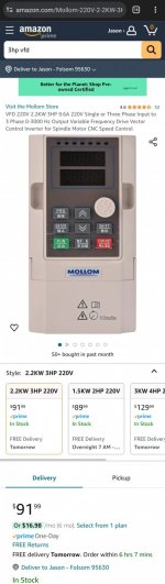

This is a fairly cheap VFD that will probably be more then enough to run the fan. If you put a plug on the output you can plug other things like a lathe, drill press, air compressor or whatever into it as long as its three phase and less then the max KWH of the VFD.
This VFD will take single phase 120-240v in and output 208-240v 3 phase. Control knobs and buttons right on it or use the remote panel

Awesome ?
Can I run like a 12-2 size wire for power, hack up a 12-2 extension cord put special plugs on it and run that? I'm sure it's not exactly "code" ?

Well yes you can. But the output needs four wires. Three for power and one for ground. But that shouldn't be two difficult as there are plenty of SOOW cords with four conductors in them. 12 awg, depending on distance is actually good for 30 amps for THHN wires but NEC limits it to 20 amps. Most regular extension cords though have PVC insulation that doesn't have the same temperature rating so it's limited to 25 amps (NEC limit is 20a). Both should be capable of running the fan with a current draw of around 16-18 amps at 120 volts. The 120 volt cord will probably run a but warm but if your not running full blast all the time you will be fine.
Now if you can find a 10 awg cord for the 120v side you'll be much better off. The output running to the motor can actually be as small as 16 awg but I'd stick with at least 14 awg
