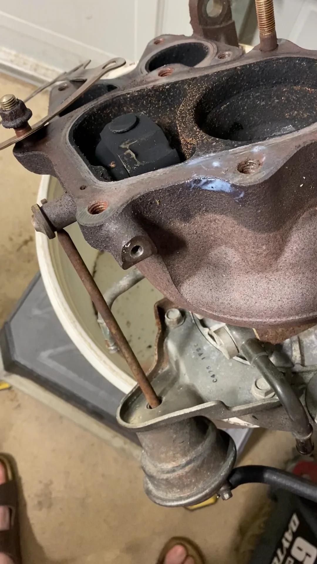

Got a call to come pick up my valley turbo. ?
