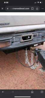

Got the hitch on in the rain tonight. I’ll slap the bumper on tomorrow. I’m very surprised that it doesn’t attach as far up the frame as OEM. The forward most holes that the OEM hitch used aren’t used with the Big Hitch Products hitch. But that said, it’s a damned horse!

Curious to see what it looks like with the bumper on.
I have a Curt with 2 inch but the 2 1/2 hangs down a bit and IMO doesn't look right. but it does tie back further back into the frame than the 2 inch version.

I really wanted that Curt, but the pics of how low it sits was just too fugly for me to bear, lol.
I will attach a pic from the BHP site, showing what to expect.

This is the 15302 on my truck. But I have seen a few of the 15703 and they have huge gap around 3 inches from what I have seen between the bumper and the top of the hitch. I guess it has something to do with the fit of the later GMT900 trucks or something. but it looks bad IMO on the GMT800.

If I didn't buy this one, I was going to buy your 2" Curt. That 2-1/2" Curt is fugly, but the worst angle is from the side. Woof!

I agree... If I could get my hands on a used one I will re- engineer it to fit properly. I doubt I will find an original 15702 which used to be specific and fit the truck better. But If I did, I would duplicate the side plates for those that want to make one.
