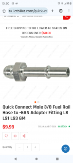

Found some quick connect to 1/2 3/8 to -8/-6 respectively as well.. help build fuel lines again
