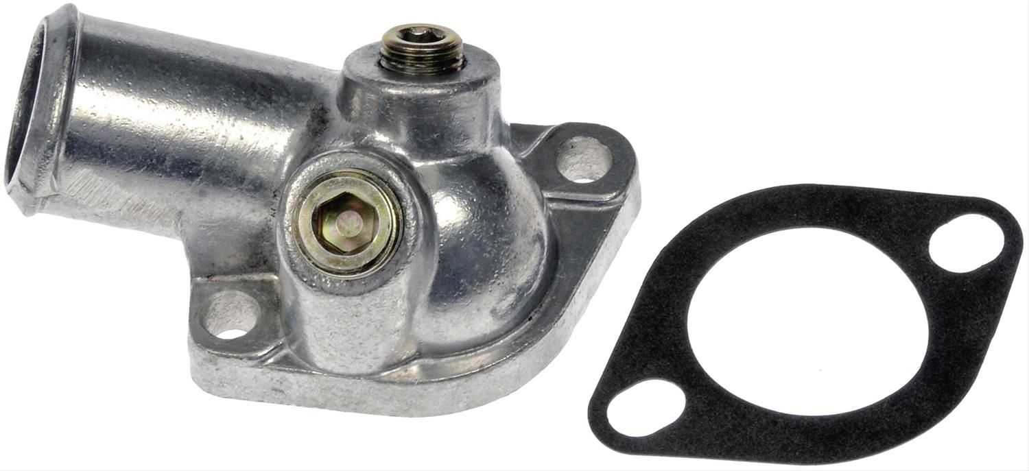

Got quite a bit knocked out on my 75 K20
including a run to jegs got old fuel lines pulled new lines ran, external electric fuel pump with 40M pre filter, and 4M post filter(wix 33481), added a return bulkhead fitting to the tank.
Need to install an ECT sensor.. either I do it this way(same Idea as the EGR delete coolant line) or drill tap a spot in the coolant cross over on the flat spot🤔🤔
Still need to mount ECM, route harness fix couple exhaust leaks that's directly upstream of the O2 sensor.
Prefilter a6n pump will go In-tank once I get a suburban tank mounted.

Is that a mechanical water temp sensor on the other side? Is it hooked to anything?
9,266
1,514
I was thinking more along the lines of an actual pre tapped hole in the block side say between cylinders 1 and 3 not in the intake or heads.
Yes that's a mechanical temp gauge, the FAST system monitors it, but you can only see it if the hand held display is connected

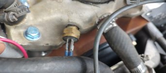

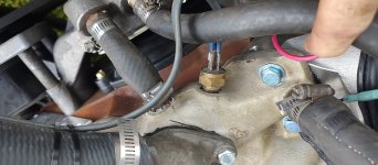

Ultimately I'm duplicating this .. this the a on/off temp switch I use to control the electric fans on my Malibu wagonIMG_20260405_194202954.jpg
