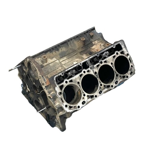

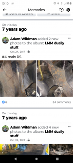

So this came up in my FB history, last dmax I blew up was 7 years ago.. failure was ripped #4 main web on a lb7/LLY block that was running main studs.
I've got 2 LBZ/LMM based dmax engines here, one needs a block other is a LMM block that needs bored..
One of the comments was @Chevy1925 mentioning getting a LML (11-16) block
How interchangeable is it?
Should I start keeping an eye out for one?

For whatever reason the LML seem to fetch a Premium but I don't know why. Supposedly a stronger casting from what I am told.
I wouldn't pass up an LBZ/LMM block though.

Yeah, increase in webbing and I think thickness in a few areas. Supposed to be stronger.
I'm pretty sure they are compatible with all prior generations with no significant differences. It's more about what gets bolted onto or into it
3,395
1,671
I think the only major was the thread for the oil sensor. I see an adaptor for sale to use older block with newer sensor for a 2011+ wiring.
https://dirtyhookerdiesel.com/i-240...pressure-sensor-adapter-fits-2011-sensor.html
You can also go the other way too.
https://dirtyhookerdiesel.com/i-240...ure-sensor-adapter-fits-2001-2010-sensor.html
