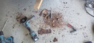

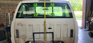

Go on this saturday by removing the rear window.
We used this tools
they done a good job

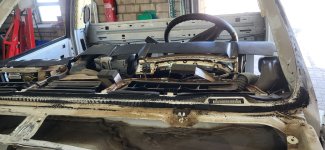

Couldnt got the windscreen out as the dashpad still sit in. I couldnt find all clamps and bolt. Looking today at home in the TM-Software and found out there a hidden clamps in the passenger handle 🙈
We will go on next weekend.
In our absence Fedex deliver the cabcorner from LMC
Shown a good quality
and with 1,15 mm thicker than usual sheetmetal for vehicles here
Glue in the windows will be done by a professional shop. I have not enough expierence for this job. I want a prooved proper sealed window.

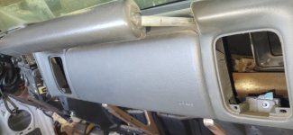

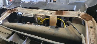

After found the clamps from the passenger handle was it possible to slip of the dashpad without cracks or other damage.
Fortunately we dont need to remove the Airbag. In Germany only certified professionals are allow to remove or exchange airbags. Thats why also the steering wheel sit still in place. We will now cover the area before we go on with the body work

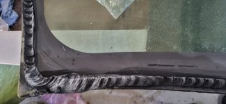

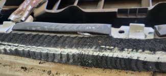

There is a lot of glue to remove
also on the glass

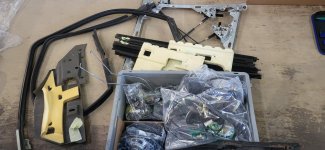

taking both door apart and found, like expected surface rust
but nothing on the bottom

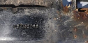

Does anybody know where i can got this stickers new?
the best tool i ever bought in this project
all parts sorted and marked for an easier mounting later

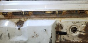

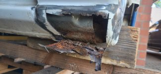

After removing all gluerests from the windowframes start on the cabcorners. Tve drainholes on both sides was a long time clogged. Rust bite over the time through all sheetlayers.
Today open both corners to have an overview of the damage.
Driverside
Passengerside
Not that bad for a 19years old truck out of any rustprotection and care
17,035
3,560
You have no idea. Look at trucks that have lived their whole lives in Michigan. Rockers and cab corners rust from the inside out on these trucks.
