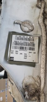

Meanwhile i got the quote for the stickers
Not a cheap solution but if you spent estimated 4000 Euro for a new professional painting than you dont want cover the stickers to spare the money.

Got a mail from ECS - the option sticker is new for them. Need some more details.
After taken more pics and measurements i noticed that these stickers will be later covered by fender and engine. Nearly impossible to check for an officer. So i think we dont need them to replace 🙈. But i take one for my own. If they are ones removed is no way back to it.
