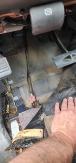

1FastBrick it seems for me that it was complete from windshield to cabfloor mount on the firewall until the cab floor. If you touch it than it fall in pieces. I could not got it out without damage. And on the top at the windscreen sane material and same problem fall apart if you touch it.
I guess if i take the dashskeleton out will the rest fall down.
It was floormetal, sound-deadening compound, Insulationmaterial, this rubber/plastic what fall in pieces on the "walls" and a rubbermatte instead of carpet on the floor.

Thanks for the offer 1FastBrick. This looks similar to that what fall apart in our truck.
If this is also an 2006 the problem will be the same about the time it sit in there. It will on the shipment maybe fall apart too if you got it out in one piece.... I am also not sure if it is in one piece from the top of the windscreen border about the firewall to the floor in the truck. For me it seems so.
When we have the dashskeleton out will it be visible.
I guess also this is not longer new available. And as it is covered everywhere is the best way to choose an universal sound deadener and insulation.
Fortunately the top rubber matte come out without any damage.
The Chevy have a similar rubber matte and over time it was destroyed. Alone the shipment costs more than the part itself. But it is still new available as aftermarket product.

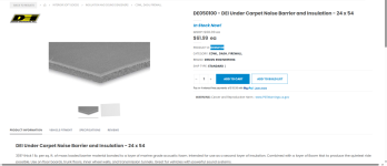

This one feels Pliable. I was un-sure how it can be shipped. I think it would require a flat crate so it can sit flat in shipment. Possibly more trouble than it worth.
In the USA we have DEI Design Engineering Inc that offers a product for similar situation.

Ours seems also pliable but broke in the moment where movement was necessary.
About DEI:
We have something similar here. You can choose a huge wide on different materials.
So i think we will find there a product which fit in.

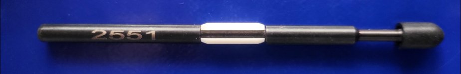

First 1FastBrick the labels are similar and in perfect quality. Worth the money as it spare a lot of time of taping for paint. Of the angle by taking picture seems they be different but it isn't so.
The Tool work pretty good
There were some more hidden screws to loose but finally it is out

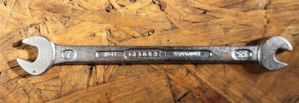

A 7/32? Good that i also have a passion for RC Modelling and have a lot of tools. A 5.5 mm done the same job.
