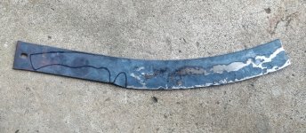

Leaf spring steel. Possibly 5160 but can be a number of different alloys. Started out well. Put the bevels and curve in. Was making a large chopper as I feel it would be a little more forgiving with errant hammer blows.
Hammered out the basic shape

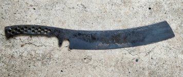

Ground in the bevels. Shaped the handle and hardened the blade

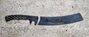

Then... During tempering. Well actually after removing it from it's 2nd cycle and cooling it off it split in two. It's weird because it didn't make any "tink" sound or any warnings. It just kinda fell off ?‍♂️
The grain structure was not too bad. Almost ideal. Just slightly more texture then optimal. But should have been serviceable. There is a brown section near the spine that gives the tell-tale sign of the issue. This must have been there since the initial quench and remained unnoticed

There is a very definitive line between the browning and clean forging. Is that do to more hammering of the bevel?
8,554
3,059
Unlikely. The "brown" crack extends a little past the straight spine section and into the bevels a little. It would also be much darker if it happened during the forging process. It would have to have gone through multiple heats for forging, normalizing, annealing and the austenitizing. It would probably be black by the time. From the light browning it more than likely cracked near the end of the heat cycles. Probably the quench where the chances are the highest
