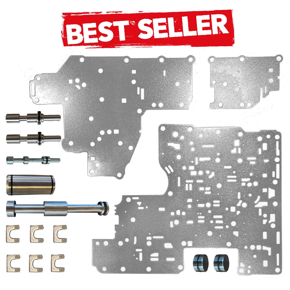

Well I've joined the club for the 10 speed transmission taking a crap. Was leaving the KOH yesterday and got on the highway and a large bang/clunk from the rear end, reduced power, drive at slower safe speed came on the dash and a check engine. My SIL hooked up his EZ link and it just produced the generic P0700. Was able to drop the fifth wheel and side-by-side off at a friend's property in Lucerne valley and actually drove the truck to the dealership. Under load the tranny didn't like it but normal gentle driving was OK.
Waiting this morning for a phone call with a diagnosis.
Pure Diesel
Apr 22, 2008
989
301
Ventura County
Anybody know how legit they are?
They're saying even the new GM updated valve body isn't going to fix this for the long term.
The dealership is telling me they don't know when new parts will be available.
3,395
1,673
Fab rats installed a kit on his truck. It is supposed to fix the issues.
