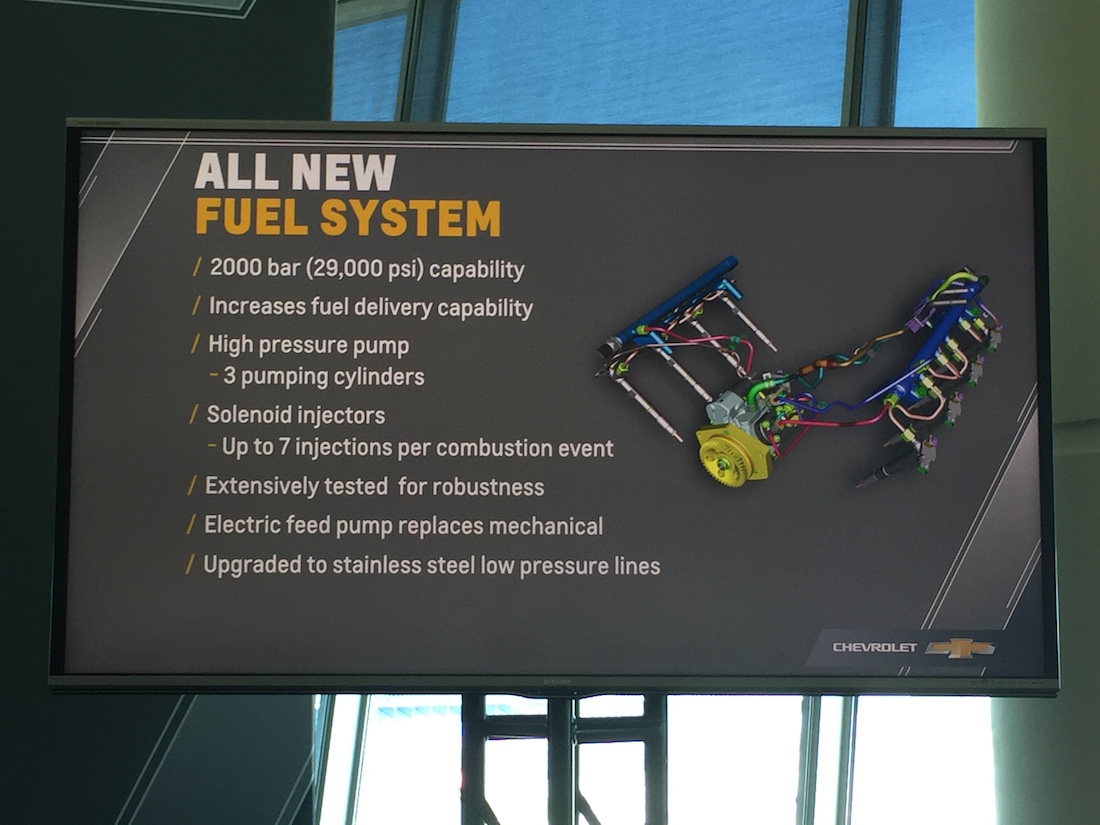

Pretty sure the pump is a Denso HP4...
Appears to be a HP3 pump according to this. Also says they finally went to an electric lift pump instead of relying on the gear driven pump on the CP3/4.

So would the HP4 bolt in place of the HP3 Ben?

It's a HP4. The HP3 is a 2 piston pump. I found the denso service documents online already.
3.3 HP3 Type
(1) Construction and Characteristics
• The supply pump is primarily composed of the pump unit (eccentric cam, ring cam, two plungers), the SCV (suction
control valve), the fuel temperature sensor and the feed pump (trochoid type), and is actuated at 1/1 or 1/2 the engine
rotation.
• The two compact pump unit plungers are positioned symmetrically above and below on the outside of the ring cam.
• The fuel discharge quantity is controlled by the SCV, the same as for the HP2, in order to reduce the actuating load
and suppress the rise in fuel temperature. In addition, there are two types of HP3 SCV: the normally open type (the
suction valve opens when not energized) and the normally closed type (the suction valve is closed when not energized).
• With a DPNR system (Diesel Particulate NOx Reduction) system, there is also a flow damper. The purpose of this
flow damper is to automatically shut off the fuel if a leak occurs in the fuel addition valve passage within the DPNR.
HP4 Type
• The HP4 basic supply pump construction is the same as for the HP3. The composition is also the same as the HP3,
being made up of the pump unit (eccentric cam, ring cam, plunger), the SCV (suction control valve), the fuel temperature
sensor, and the feed pump. The main difference is that there are three plungers.
• Because there are three plungers, they are positioned at intervals of 120? around the outside of the ring cam. In addition,
the fuel delivery capacity is 1.5 times that of the HP3.
• The fuel discharge quantity is controlled by the SCV, the same as for the HP3.

I think those are their G4S line of injectors too, but I'd need a better picture to tell. They're solenoid like the LB7-LMM but fire quicker and return a lot less fuel. Basically the benefits of peizos but cheaper to produce.

Yeah, not sure how they denote their classifications but the HP4 is similar in operation to the CP3.
The HP0 is similar in operation to the CP4.2, 2 piston and they can be configured to pump up to 4 times per revolution versus the 2 the CP4.2 does.
