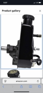

Mine came out the side instead of out of the back. The one I replaced came out of the back. I couldn’t get the ecm cover back on either.
N2BRK
Dec 31, 2009
2,393
733
Not the same as mine.

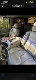

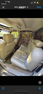

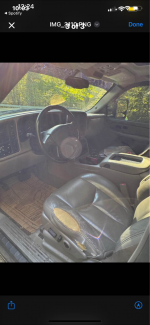

I grabbed front and rear seats, console, and door cards today. All in great shape except for driver seat bottom. Black Friday should take care of that, lol. Donor was an ‘06.
