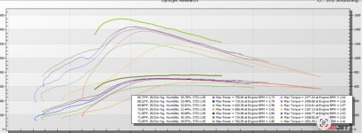

A somewhat comparable truck a customer of mine has is an LB7 with a Stealth 67G2, my built trans, 10mm, LDS SAC65% and it's holding rail just fine and making some jam. I'll dig through his logs tonight and see what his pulse and current is looking like (I'll post the log file too).
