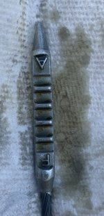

Turned out not to be the injectors. Valley turbo was pushing oil which is strange because that was my first thought and I had the atmosphere out and didn’t see any oil. Started pulling everything apart planning on pulling the valve covers and there was oil in the downpipe.
Was only pushing a little oil so it would only smoke when you were on the throttle or after you ran it hard until it all burned out. Idled it with the cross over pipe off and it would only blow oil when you revved it. Still doesn’t explain while the oil looks so clean. Going to have to do an analysis. Going to rebuild the turbo and throw a new wheel on it, this one is all banged up.
Still not a fun job the oil drain bolt on drivers side it a pain in the ass.
wydopenLb7
Mar 10, 2023
108
46
California
It looks like it’s been a little hot before.
Glad you found the source. How old is that turbo?
10k miles. Had been sitting around for a long time before I put it in though. Was pretty dirty but I cleaned it up good before I installed it but I didn’t pull the compressor wheel and pull the shaft out.
I was wondering about the color also. My old one I took out was the same color too but had 330k on it..It’s getting coolant and ect’s never over 225deg and only once even that hot. Egts barley hit 1050deg with the compounds.
I did just run it real hard towing 15k across the desert in 110deg weather without the remote oil cooler though..
