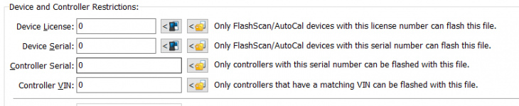

You can change the vin on the ECM using the scan tool. But if you want to load a tune, you'll need to license the ECM
036.6turbo
The VIN can be changed with EFILive, allowing Rob's tune to load after a VIN license is purchased?

I don't remember that? Seems like just the VIN. But hell, that was (9) years ago. LOL
It IS possible, although exactly when it was introduced, I don't know. It IS possible that the OPs tune predates the ECM serial number lock I suppose. I can say that my IdahoRob LBZ tune is not locked in any way...... So if I were to take a tune, restrict it to the SN of my ECM, and then send it to someone else, it would barf.
Yes
Use the scan tool first to change the vin. Then license the ECM and load the tune
The tune from Rob has all zeros in the serial number field. I do not believe he used the serial number to lock it to the ECM. It did a full flash on the replacement ecm.
Well, that's good news on the Tune. Interesting that it still won't run though... Seems more likely at this point that there's a mechanical issue at play (unless of course you got the cosmic bad luck of getting an equally bad replacement ECM). No monkeying? no chance the crank and cam connectors got swapped? Stuff like that? Will it try to run on brake cleaner or ether (with glow plugs disabled for ether)?
