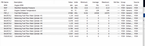

The old girl is still running great. But seems to be thinining out the motor oil now in under a hundred miles.. Apeared out of the blue after the the CP3 swap.. Oil pressure low, couple extra quarts on the stick. Changed oil, 75psi cold idle, 100 miles later, 25psi cold start... Dang it...

Its a 22 year old truck with no known history on it. Not surprising. Set of SAC00's should fix that right up, if its injectors. Considering you said a while back that someone had been under the covers, it could simply be an hp line leaking, too.

Oh I know. That unknown history is constantly showing signs someone with unknown skills was chasing fuel problems on this far longer than I have been.. And what looked like a good deal for a southern truck, is quickly eating up it's value in repair costs.
Find it strange it only starts leaking after the CP3 LBZ upgrade. Pulled a camper 1000 miles when only 10k PSI rail, no fuel in oil. Replace the CP3, and now it's leaking further down the line. Verified it will hold 23k PSI on the rail just off idle with a scantool.
So new question is, rusty line on injector, return line issue, or did it crack an injector body?⁉️

NC is more-than-likely right, but there's only one way to find out for sure.....
Hopefully its just a HP line fitting leaking. Doesnt cost anything to throw a wrench on the fittings outside the covers.

Had two on passenger side that took a good 1/4 turn, and one on drivers took another 1/8th.. Swapped out the oil and put a fresh 10 miles on it so far.
