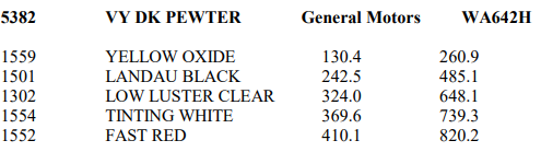

I'm attempting to repaint all the headliner trim pieces, overhead console, etc. I was having a difficult time getting the paint to stick. I went back and looked at SEM's website for clarity and I noticed that what I was using (Classic Coat 17223) was not compatible with plastic. After watching a video I found an easy way to identify which type of plastic it is. My overhead console in particular has a PP stamp which means it is a Polypropylene type.
So I called and spoke to a rep at SEM who confirmed that I needed to be using Color Coat, not Classic Coat. That led me to my next question. There was no aerosol option listed for Very Dark Pewter. He then proceeded to tell me that for this specific color I would have to have it mixed for me at a distributor. He gave me the Formula Number that they will need to mix it. The Formula Number is: 5382.
So to recap SEM recommends that for the Polypropylene type of plastic that you use the XXX Adhesion Promoter and SEM Color Coat custom mixture formula #5382.
Hopefully this is helpful to someone in the future if needed.
