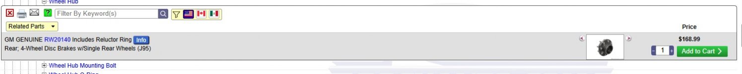

Ok, did some digging on Rock Auto Using a 2012 2500 with 6.0L RPO Code J95 looks like it has a rear wheel hub with tone ring.
Going on Ebay it looks like it must be from a 2011-14 and 15-19 and I believe it needs that code J95. the flange on the housing has a place for the sensor to bolt onto on the front side of the flange.

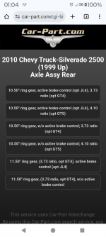

It probably falls under cab bed make set-up much like the 1150s do to wether they have 3 or 4 channel ABS
Iirc it's JL4 rpo for stabilitrac
