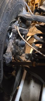

You can put 8 lugs front hub/knuckle assembly on a 1500. But it messes with the alignment and the top ball joint angle is not optimal. I think you need a fabricated style arm to help correct for it. I had someone do it but the truck was stolen before he changed the arms out to see if it would correct the alignment. From what I remember, You also have to use a thick washer as the tapper is larger on the 2500 knuckle and it runs out of exposed thread on the ball joint. So in order to tighten the nut he used a thick washer, and he put some miles on that truck too like that... almost 250 miles 1 way to come down where I am.
He had installed a 2500 NON HD 9.5 rear axle and the front knuckle hub assembly from the same truck on his ride. He was rolling around on stock 8 lug PYO Wheels.

Yup. 99-00 2500 spindles, which have a 1500-size tie rod end. Flip the upper arms, use an offset ball joint and a stainless steel ball joint "adapter" and away you go. Thats how i set mine up.

What's the ball joint adapter you mentioned? It fit's the taper???
Yeah I remember him being off about 1-2 degree in Camber I believe and either needing offset bushings or offset Ball joint to correct it. I don't recall flipping the arm. Was that to give a better angle on the ball joint?

Look up "ball joint taper bushing". Yup....they're a thing. I forget where I bought mine, its been so long ago. Its in my 1/2 ton thread somewhere.
Those Moog offsets are some heavy-duty pieces. In that pic, the joint is turned completely inward.
Yes, flipped the arms to give a flatter mount for the ball joint, considering the 2500 spindle is a couple inches taller than the 1500, but aftermarket would be better. I actually read about doing that on PT, so I gave it a try.
