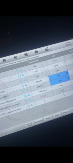

Well I'm back new injectors and lines still crank no start trucks desired fuel rail pressure is calling for on crank is 6000 psi and it's cranking to 8400 psi still nothing truck has rpm signal I'm still pretty lost

Any smoke as before? Or at all?
EDU fuse?
Cam and crank sensors? Missed pulse count?

Zero smoke im going to check the edu fuse , this scanner doesn't have the option to look at cam and crank sync but my rpms are jumping up on crank and ill check on the missed pulse count

Maybe crank pin sheered and the reluctor is off?

Ill remove the serpentine belt and check for play on the balancer but the motor sounds pretty even when cranking I did hit it with a bit of wd40 it did start for a second and sounded pretty normal it hasn't started since I'm gonna be borrowing a scanner later to see cam and crank sync and one thing I did notice the ficm hasnt had the plug in it since I got the truck wasn't aware prior to what that's what everyone talks about

If it just slipped and went out of time/sync
What's the best way to figure that out
