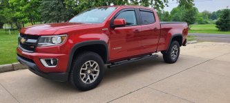

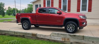

The Mastercraft AT/MT tires the p/o put on the truck started humming pretty badly, and I wanted to move on from the ugly-to-me chevy wheels anyway. Found a set of Canyon 17s on Marketplace, and bought a set of 265/70R17 Nokian One HTs off TiresEasy for -- get this -- $108/pc! No more hum and I like this look better.

Looks sharp! The proportions are much nicer with the long bed and crew cab. I never have cared for how my dad‘s crew cab shorty looks.

These freakin tires are quiet. We took a trip and could actually talk to each other at a normal volume. I'll use the Mastercrafts in the winter.
