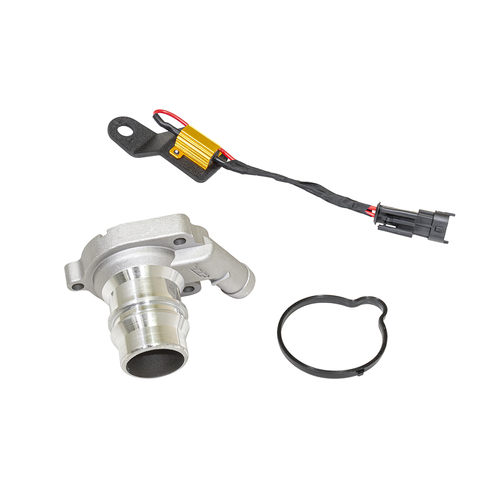

ZZP has the t-stat upgrade in stock, with 180° t-stat
that should ship out tomorrow...
