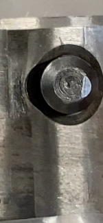

I had a leaking gasket on my fill bolt on the rear diff cover. Rather than replace it, I grabbed another cover and swapped last night. I found this chip on the drain bolt magnet. I’m a little worried it’s from the new Truetrac, but I don’t notice anything wrong when driving. Oil wasn’t glittered. Visually everything was good. Hmm. Maybe no cause for concern??
