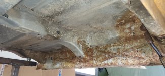

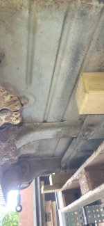

After we couldnt flip the cab backwards without a possible damage to have a better access on the bottom skip we this idea and go on with welding an undercarriage.
With the doors and still the complete dash inside is the cab much more heavier than the complete empty chevy cab in that process.
So i grind the plan surfaces of the cab just before lift it on the undercarriage.
Now i start to run out of left-over-metal from othr projects in my shop... But i make the cab complete mobil which make any job on it easier.
So we will use also our lifter to become more space under it to work on the bottom, but we need to work over our Head, thats a lot more exhausting as having the cab flipped backwards. However it must be done and a short overview shown there is not much what we need to do on the bottom.
Still in place the old brackets from the Stepinside. This will be complete remove.

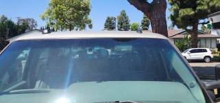

Does anybody know if there are heated windscreen replacements for this truck available? 🤔😇
No heated front wind screens available. Only the rear has that option. The Front uses the defrost function from the heater on these.
They do have an optional glass with a blue tint at the top for sun.

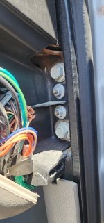

These are the main points of connection.
Along with the top screws i mentioned the whole assembly will come out. You need to un plug the steering column and remove it first. There are 2 nuts and the stereing joint holding it in. Just keep the wheel straight and dont let it rotate. Keep track of it if it moves and return it back to straight position. Other wise the clock spring can become damaged.

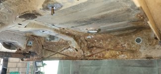

Prepared all to weld on thursday as the zinc epoxy primer must first dry.

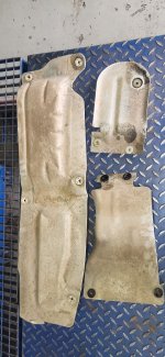

Meanwhile we disambled the heatsheets.
Of course there is always one bolt which break...
No holes the cleaning will shown how much quality is still there

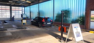

About the stickers i am not sure if this is a feature for roadlicencing. Tirestickers for example have also our Volvo. The C30 had last month his annual technical checkup.This sticker was not controlled
On the licenceplace is now a brown sticker which point out directly when the next checkup is schedulded.
But you can be sure if missed the stickers on the Sierra will it be point out as failure...
