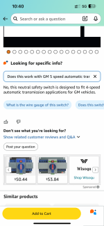

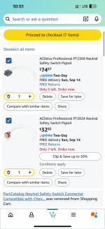

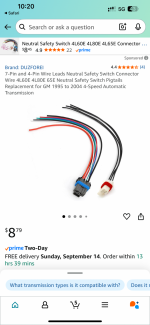

I don’t have any problems starting and never have. Just won’t lock into any gear, don’t notice any difference in rpm between park-reverse. I’ve ordered new parts and will give it another go when they get here.
This is the 4 speed switch and connector ordered. I don’t know where the confusion came from between the 4 & 5 speed but it says even the harness is not compatible with the 5 speed at all. Not sure why, I can’t find much online about the 5 speed connector. All I can find is the AC Delco but they’re $100 together. Could you help me find that through GM?

You're looking for the OEM connectors?
Fleece FPE-HAR-GM-NSBU-0104 or DHD 100-448 are solid options. Fleece runs $79.99 + shipping and DHD is $89.95 + shipping, both work very well.
If you need the NSBU & plugs, Merchant 10499 is also another option as it's a NSBU and connectors for $289.94 to your door.
