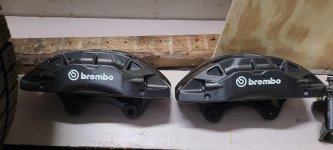

I went with euro-spec pads and coated rotors from a company called Dynamic Friction. Its only going to be a DD, so nothing special.
