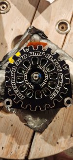

Decided to get myself a mechman 370amp alternator for the truck. A Christmas gift to me. Also looking at getting a aluminum radiator with dual 16" brushless spal fans. Have a choice between 2.25" core and 2.75" core for the radiator. Not sure what I will go with. Thoughts?

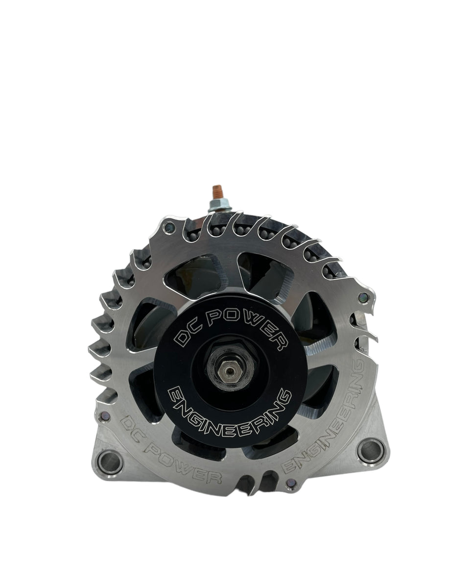

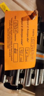

Mechman alternator showed up today. New turbo will be here next week sometime.
You won't be dissapointed with that alternator.
We bought a 270A from DC-Power (I'd say they're both on par with each other) and after the abuse it went through I will run nothing else. We bought it in 2016 for our shop 6.0L Powerstroke and in that time it has accrued 70k miles, plowed snow commercially for every one of those years (4-12hrs, sometimes more) at a time, was used for various high current jumpstarts on large equipment/vehicles etc and it FINALLY had an issue.
It appears the voltage reg has failed. With that, I sent it back in to DC-Power and they're going to go through it, repair it, and recase it for my Duramax application (with black front/rear billet housings) for $240 which is killer. Below is the alt in question.
Reed makes some killer turbos! What size did you end up going with again?
