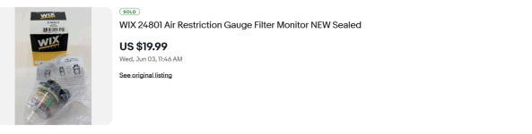

Saw a truck like you're describing that had a bad air filter. Under load the filter would suck into the intake tube.
That’s what it is it had mine waded up in the tube damn near nearly brand new Napa gold what’s the best bang for the buck on cold air for one it’s a work truck gets more gravel roads and dusty fields than most probably do
