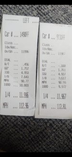

11.88 is the boom boom tune, others are tune 4
23,034
8,047
I dont think that 100hp is 100hp. You gained some et from that better 60ft and you were only a tenth faster in the 1/8. Had it not sputtered, you might have only gained 2 tenths instead of 1. Mph is not overalling much more at any spot either.

I agree fully, from your previous post of not being needed as far as the sending unit it had to be replaced and i plan to make a project out of it since my OCD is fierce lol. I'll be doing the entire underside of the bed in raptor liner and if any rust is on top of the frame addressing it then and there. As far as that 100hp I do wonder if fuel has been holding me back or if the tune is "detorqued" too much. Moving forward I'll be doing some other stuff too, probably shock relocation and eventually lighter/forged wheels

As already mentioned above but I agree
The better 60’ time netted you the better ET.
I don’t feel the 100 more hp was the difference
I agree. Hopefully with relocating the rear shocks and going over to qa1's in the rear too(front has double adjustable)will net better 60's. Also curious to see if the fuel restriction has any effect on ET

Just figured id update you guys, 2 weeks ago I took a week off work, ripped the bed off and did the whole project. Ended up doing ss brake lines while the bed was off, new tank vent amongst a lot of other odds and ends. Shot the entire underside of the bed and wheel tubs in raptor liner 2k, got the top side of the frame cleaned up and all that
Upon sender removal I saw nothing restricted that would've caused my issues. Oddly enough the violent launch must have jarred the sending unit float arm in the empty position and had an 1/8th in of a stiff spot. Maybe im thinking irrationally, im wondering if I had some sort of cavitation issue this whole time. Since the replacement ive beaten the brakes off this thing with logs and am not seeing any sort of difference between desired and actual frp. The next time im at the track im going to log it just in case, oddly enough the one log I recorded on snap won't let me upload the file. May have to upload to YouTube and then transfer onto here
LSxBakakos
May 29, 2022
136
26
Illinois
Update. Raced last friday, something fueling wise is definitley going on. I put 5 more gallons in on the way to the track, possibly got bad fuel.
First pass was tune 3, 12.90@103, first on the hot tune was 11.96/114, truck started to flat line up top, not sputter as it did before. Just completely stopped pulling. Following passes got slower, truck is 60ft'ing like shit, tenth slower in the 1/8th, 2 12.0 passes after and I stopped racing for the night. Truck used to run 11.90 in tune 4, tune 5 was best of 11.88. Last pass I data logged off my Matco scanner, definitely was losing rail on desired and actual. Im unsure if my valley cp3 is failing and the brain box for the 2xcp3 is shutting off the valley pump, bad fuel or something else im missing. Thought it was odd both dipped off like that, I was expecting it to have a significant difference between desired and actual. My scanner does show a delay but it seems it dropped to 12k for that second or two. The FPR has stuck before and tcw3 cleared it up.
