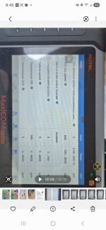

Recently went on a long 300-mile drive and when I finally came to a stop, I heard a whining noise, almost like a PTO. As soon as I shifted into N or P it went away and I felt the truck relax. So, I figured the TC was going or maybe the VB or Solenoids were clogged etc. I dropped the pan, other than the fluid being slightly dirty, there wasn't any debris in it. I would have figured I would see something in there. It was clean as a whistle. I even strained the fluid with a super fine mesh. So, I bought all new OE solenoids, manifold and a transgo while I was in there. Cracked the VB open to make sure to clean the filter in there too. All really clean. It's reassembled now and it does the same exact thing still. Looking at the live data, the TCC command pressure is 0 at idle. I wasn't able to find a table to go off of for these values to confirm if it was correct. My thoughts are, either it's a wiring issue or TC. I kind of think I caught it early since there wasn't anything in the pan as far as debris. Any thoughts? I should have checked the internal harness while it was apart, but I was kind of rushing to get this back together.

Logging slip at a standstill won't do any good as the clutch should not be trying to apply. The pictures you posted look correct though, in drive or reverse the turbine speed should drop to zero until you start to move

What does engine RPM do when you accelerate from a stop? Does the converter allow the engine RPM to flash up to a higher RPM, or does it act like a manual transmission with a clutch? What your scan tool is showing is completely normal. You should see no slip in park/neutral as there is no load on the input shaft of the transmission (turbine speed is free to match engine RPM with no load meaning no slip). When you place the transmission in gear, the input shaft is locked to the output shaft which means the turbine will stop and will turn at a speed relative to the output shaft and the gear ratio that is engaged. At a standstill, this will result in 100% slip.
No surge in rpm. No slip at all. Put the truck in gear, and it feels like 4w lo trying to push through the brakes. Put it in neutral or park and it goes away immediately. Rpms are noticeably lower as well in park or drive when stopped

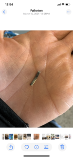

That would also include the radiator too. This came out of mine when I lost the stator.
