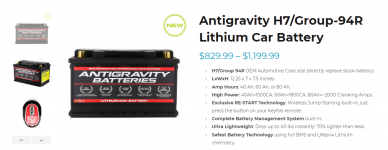

looking at those specs again I find it hard to believe the 1500 CCA. that is some crazy high C rates for lithium batteries. just over 37 C. most high output lithium such as the LiFePo4 which that battery most likely uses is normally limited to 10 C. some can do up to 20 C for short duration but 37.5 C seems risky form a business standpoint. they are probably banking on the fact that the resistance of the wires, starter, grounds, etc will limit the current to something more reasonable and no vehicle will actually pull 1500 amps

It's CA not CCA listed in his post, they are two different measurements. CCA is measured at -18°C/0°F and CA is measured at 0°C/+32°F. The picture below also is pulled directly from their website.

regardless of the temperature 37 C is extraordinary for lithium chemistry. and if you look at the photo posted it says CCA so that's what I based it on

thinking about this further, I would bet substantially that they employ a bank of super capacitors to give the cranking amps even when cold. I've been using a similar setup in my previous LB7 and currently in my TDI. I have 6x 3k F caps in series for cranking and another 4x 38120 headway cells rated down to 14°F for a little more capacity. the BMS only manages the lithium cells for lower current charge and discharge but the capacitors handle the cranking power. mine is rated at max CCA of 1900 with a short circuit current of 9300 amps. and because this all fits into the old gutted battery I would bet they did something similar. and not to brag (but I really am ?) mine was less then $200. unfortunately it is only about 10 AH capacity vs the 40 AH of the antigravity one. but I could have increased it if I needed
