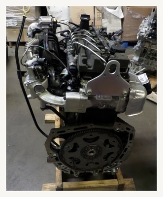

Then i got to thinking about the lwn duramax. I found a company that does a stand alone harness and tuning for it but am i stuck with an auto?
Anyone know what bellhousing pattern they have?

The 2.8 Dmax should be the standard Chevy bellhousing pattern. Plenty of conversion kits for gm to jeep trans

The one pic i saw of an lwn on ebay had an odd non symmetrical rear pattern. Don't know if its like the 6.6 in that theres an adapter plate to the good ol chebby pattern?

From the pics I found it is some oddball bellhousing pattern.

Well that’s dumb, stupid on gm’s part to do that.
