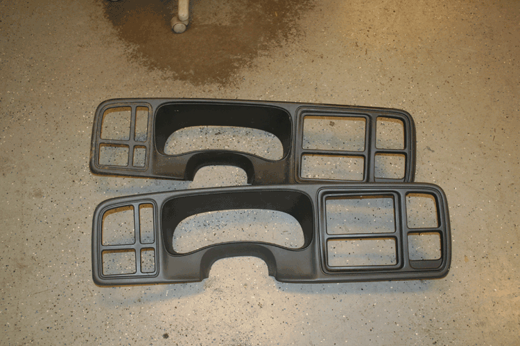

Double Din in an 01/02 fits weird, and you'll either need to trim the dash and make a little gap covering piece, or I think there's a high dollar new dash facia that you can use.
16,915
3,419
You guys made me go back to Diesel Place again......
Use an 03-up bezel, found in a junkyard. The rest is just time and fab work. Flow3n, you really dont know what you're talking about.....
3,307
1,617
Actually there is an aftermarket Double Din Kit that comes with a new facia for the 99-02 trucks. I think Metra sells it but not sure who actually makes the kit.
The AC controller being different on the 03-07 classic Requires the 99-02 AC control unit to be droped down to fit the 03-07 classic bezel properly.
I will get you a picture of one later today from a buddies truck.
The kit is like this for the 99-02 trucks.
3,307
1,617
Ok my buddy got the Sosche kit on FleaBay. I see it also sold under Metra as I posted earlier. Crotch Field I believe sells the Sosche but at a higher price than FleaBay or Scamazon.
