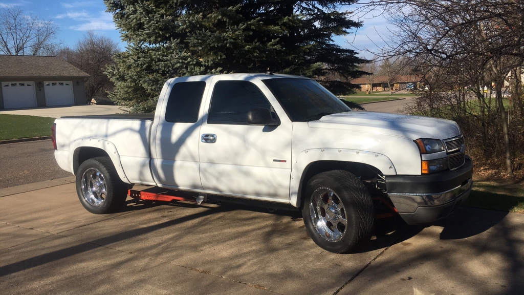

2005 Chevrolet 2500hd
2005 LLY

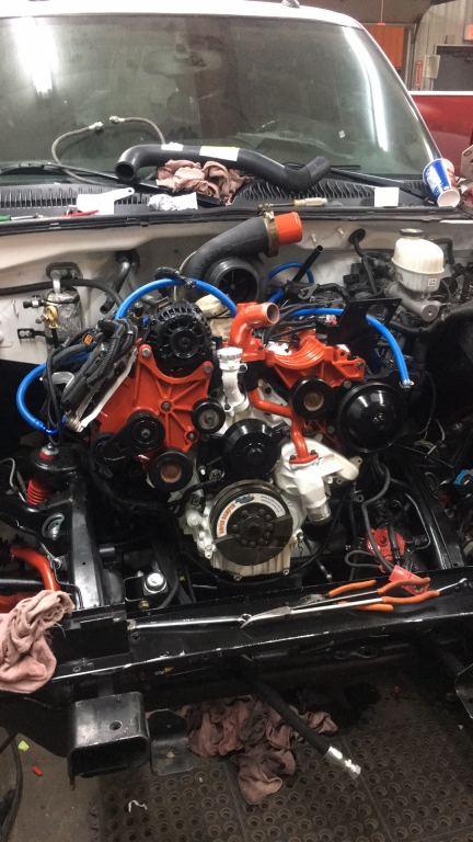

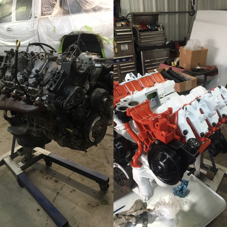

LLY block:
-Mahle .20 race cast pistons-
-Thermal coating on pistons-
-.075 valve reliefs-
-Carrillo rods-
-Keyed crank-
-Shimmed oil pump-
-Keyed SoCal 6460 cam-
-Main studs-
Valve train:
-LBZ HEADS-
-CNC PORTING-
-Rev valves-
-1.400 Intake valves-
-1.304 Exhaust valves-
-SoCal pushrods-
-125# SoCal Beehive valve spring kit-
-Arp head studs-
-Arp rocker assembly hardware-
Fuel:
-Exergy 250%'s-
-Exergy 12mm-
-Lbz pump as a dual-
-Airdog II 165-
-Stock fuel cell with a sump-
-1/2" feed-

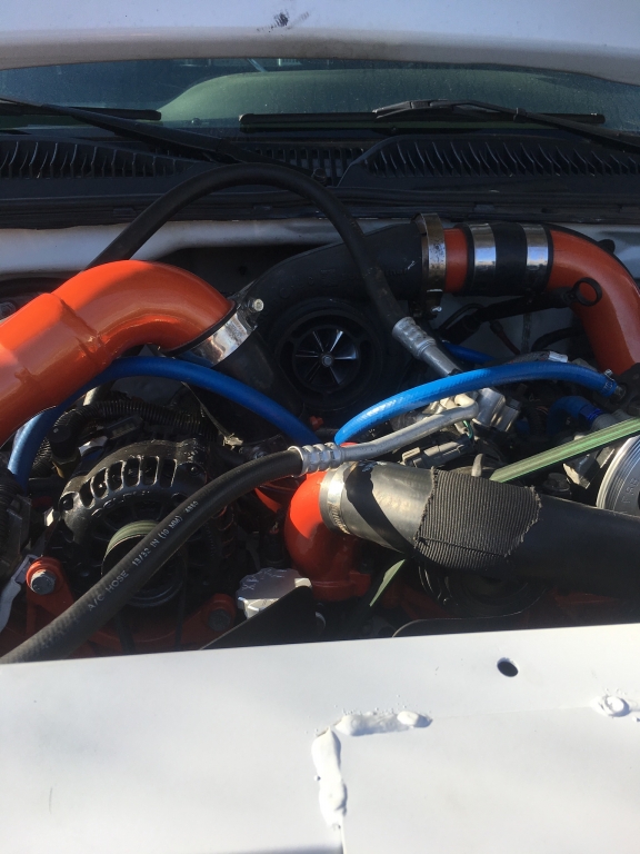

Air:
-Single S478 on a t-4
