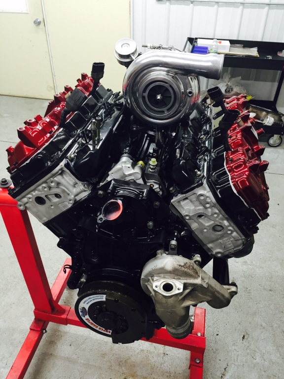

engine built by Wehrli a Custom Fab
Tuned by Duramax Tuner
Specs;
Socal Girdle Kit
Carrillo Rods
Fingers Oval Cast mahle Pistons 16.5:1 Ratio, .020 with valve reliefs
New GM Oil Pump
New GM Oil Cooler
Comp cams Valve springs and Retainers
Ported Heads, 5 angle Valve Job, New Seals and Guides
Screw In Injector Cups
New Exergy 150% injectors
Air dog 4G
DRP Fuel Sump
Socal Billet Injector Hold Downs
Socal 9100 AF Cam
ARP Headstuds
ARP Rocker arm bolt
SoCal Damper
Suncoast Billet Flexplate
ARP flexplate Bolt Kit
PPE manifolds
PPE Intercooler
WCFAB 2" stainless Up pipes
Merchant Motor Mounts
Dual CP3's
pushrods
WCFAB compound kit

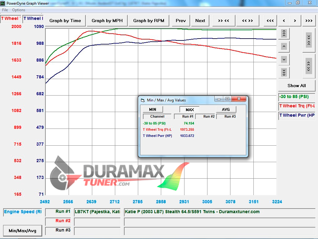

(S591 over Duramax Tuner stealth 64.5)
