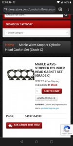

6,403
1,759
When you see stuff like this you just assume wave stopper is Mahle.
But I didn't see anything on Mahle's site that actually said wave stopper
Reactions: 1FastBrick
