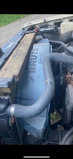

You guys talking about that wagon wheel make me think of what i did to mine. I had initially taken a dremel and cut out all the wagon spoke looking things and only left the mounting points like the LML and newer are. Makes it much easier to get to things. I have since removed that wheel altogether tho.
