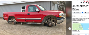

Spit balling and exploring options for this turd.
Came across a 2WD SCSB GMT800 abandoned project. Minimal rust.
Got thinking about building a 2500 SCSB. Just remove the running gear from the red turd and install it on the SCSB frame.
But, the 2WD has coil springs in the front and I believe a rack and pinion steering. I wonder if the control arm mounting locations are similar?
3,395
1,674
Oh boy... the front frame section is slightly different. I think the rails might be the same but the crossmember is welded in and different from the 4x4 style. Not to mention the torsion set up and the trans crossmember.
Now if your front frame section is solid enough, you could graph it on to the 2wd frame. The seem is right near the front cab mount.
Yes the 2wd coil over style uses rack and pinion on the 1500 frames. Alot of little things are different between the 2wd and the 4x4.
