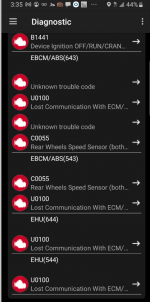

Attached are the codes detected when the first ECM failed, before the truck was towed to the dealer. I did not clear them so they had something to start with.

Attached are the faults after installing the replacement ECU, Feb 14th. That ECU was initially starting intermittently, the next weekend it fired up like normal (almost) and I tried to take it for a test ride, it died about 5 miles from home.

Thanks Dean, I will put that on the list of things to inspect. I am still looking for the pin to pin diagram of wiring that feeds the multiple ECM fuses as recent testing at the fuses show low and sometime no voltage feed the 25A circuit to the ECM. Fault code 0100, Lost Communication With ECM/... seems to be a reoccurring theme, back when this started, which could be bad GLAN wiring but could also be the supply voltage is insufficient to power the ECM. The latest clues, at least are pointing in that direction.
15,310
1,600
Did you reprogram the new ECM for your injectors? That would eliminate at least 8 of those codes you have, maybe more.
Dead/dying batteries will also cause many odd codes to show up, and I see "low voltage" in there, so.....
That list of codes was what appeared immediately after installing the replacement ECU, which was sold as a "stock program" with my VIN the only customization. After the truck started (not the first, second, or third try), I let it warm up for a long while just siting in the driveway, but did not drive it that day. I cleared the initial mess of faults, including the injector faults, Regen fault cleared, and never came back. The single bad Glow Plug remained but I have had that one for years. A week or two later, I was brave enough to drive it but it hard failed on that trip, 5 miles from home, had call AAA. Norther tool had a cheap code reader on sale, and the next time I used it, but it only displays on the hand unit, could not save to phone or pc. On April 14th, the following were the only remaining faults: U0100 ABS Loast Comm with ECM/PCM, C0055 Rear Wheel Speed Sensor Circuit Malfunction, and EBCM O8600, EBCM U8600. Since none of the Fuel Injector faults returned, I wrote that off as new ECM getting powered up for the first time. The one fault that keeps reoccurring is U0100, which left me speculating GMLAN wiring failure or the new ECM is now also Dead, Dying or not getting power. I was hoping to find more info on B1441, but that also happens to be a popular fuel filter PN and that is all the search function returns hits for.

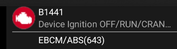

1654033869041.png Not sure it that is a fault or just a status.
View attachment 108323 Not sure it that is a fault or just a status.
That being the case, you still need to program the injector values to the ecm. It's not QUITE plug and play like thecLB7/LLY would be... They can be copied from the gpcm to the ecm with a tech2 or efilive v2. Like Tom said, that would likely eliminate at least eight of the codes you have.
